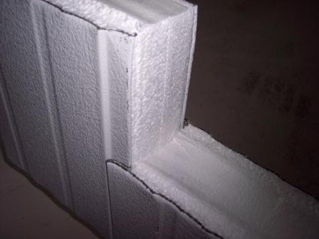

24 Feb 2009 02:12 PM
Canes;
The "shadowline " is a private labeled made for us thru www.SipSupplyInc.com
The main differences are Actech is a 3" roof and wall panel 24" wide PU core, G-90 skin
Shadowline is a 4/6/8/10/12" wall/roof panel 45-1/2" wide with an EPS  "performguard" core, galvalume skin
Not sure about a Plant City company?, there is one in Lakeland, if that the one, they have "without authorization" used my job photos, used my projects as models and pasing them off as their own jobs.
But, that is not the first time , there is also a builder in Tampa and one in Mississippi doing the same thing, I think it speaks volumes to their integrity.
