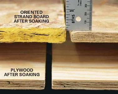

Our experience with OSB has been it will swell after one rain
The photo below shows swelling after an overnight soaking according to the article

If you look at that picture it says " after soaking" not rain.
Yes if it was sitting in a  pool of water that might be the case. It most real world situations that does not happen.
OSB is used daily in the construction industry and in all types of weather. The normal precautions taking during building( as with any other material) results in good results and no future problems.

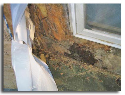

The picture below is OSB that sustained water damage in house that did have wrap on it

The window in that picture is installed wrong!  The building paper is going to funnel all the water behind it staight to the shealthing.  The paper should have been wraped around the window opening and flashed properly.  If I were that home owner I would be very upset with my contractor.  I doesn't matter what building system you use if it's installed wrong its crap!

I myself cannot determine from that photo whether the window was installed incorrectly or  did the the OSB swell to the point of blowing out the frame?
I have personally seen 7/16" OSB swell to an inch thick from an undetected roof leak.
The whole point is...... if and when you get a leak in a house OSB will be affected, by swelling, rot, mold, etc...... galvalume steel will not.
