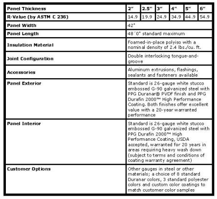

Here are some specs.

panel type

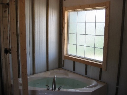

Here's an interior closeup photo. You can see the ribs in the panel skin.

How do you achieve R-54.9 in a 6" panel? Also, why the need for all the furing strips? Just curious.

I don't achieve R-54, thats what Alumasheilds specs say. I don't really get into splitting hairs over that kind of stuff because when an R-value is quoted, a temperature range needs to be posted with it, or it doen't really mean anything. All I know is that the R-value is up there and is superior to many wall and roof assemblies.
The furring provides a space to run electrical wiring or water supply piping before the wallboard goes on, so that you don't have to cut into the panel or conceal wiring/pipes so a building inspector can't see them..
ps: In the specs it says " R-value by ASTM C 236, you can look that test up to see its criteria.
