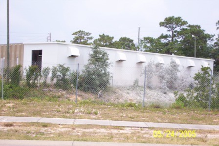

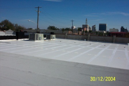

it is possible to do that and we have done it as well, for economy, metal sips can have a dual purpose, we did it on our own warehouse too.
But there is no beauty to an exposed metal roof or wall, they will require attention to the tape every 10 years
the roof has to be simple to accomplish it (no valleys, dormers,etc.)
many refrigerated warehouses have been left exposed for years, walls and roof, with proper maintenance will last for many years more. I prefer to rely on the metal sip as a secondary water barrier, for aesthetics and ultimate longevity.
if it was a shed, garage, warehouse, etc, they are just fine
