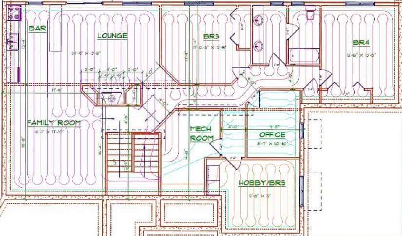

Hi,
We came up with this schematic for our radiant circuits. We're DIY and our first radian project. Any glaring errors that those with more experience can see, will be really appreciated. The bar/lounge/family room are one circuit (300 ft). The BR3 and BR4 plus bath are another(300 ft). The Office/mech room is another (150 ft), and the BR5 is one (150). I think we're using 3/4" pipe.
Also, is it good idea to put wiremesh on top and bottom of pipe? Just on the bottom? Or none at all and use little clips?
Thanks!

22 Aug 2008 05:06 PM
dont waste your money and time with large diameter pipe. no reason to run larger than 1/2" here.
do not go over 12" o.c. in a residential slab.
you should really try to avoid walls more. You are exposing yourself to a lot more puncture risk.
Also I suspect you still have not done a heat loss and so you have no idea how these circuits will perform, or whether on center distances should be adjusted. concrete is forever. it would be a shame to have to run ten degrees hotter forever because you didn't compress tubing in a higher load or more resistive floor covering area to compensate. that means carpet areas especially.
hope that helps.
lifted wire mesh has a slight performance increase over tubing at the bottom of a slab, it's slight, but since mesh should be lifted anyway if you are a purist that's the way to go. Otherwise, foam stapling is a very fast install, or something like crete-heat is even faster; and cheaper than foam staples. wire mesh/ties is the cheapest, slowest, highest performing option.
22 Aug 2008 05:09 PM
btw, nice looking drawing work though. I always look at problems first, working on trying to recognize the positives too ;)

Thanks Rob. You are correct that we have not run any numbers. How do you do a heat loss analysis? Is it something that I could try or do I have to hire someone to do it?

nice picture. I assume that this is a slab on grade.
Since the tube spacing is all the same it appears that no heat load calculations were done. I recomend doing this before you go any further.
For the tubing design I recomend that you stay away from walls. Do not go under except where you need to. You also dont need tubing under your kitchen cabinets or in the closets. I would use more loops at a closer spacing. That will allow you to lower the water temperature.
Where are the expansion joints for the slabs? you have to run tubing under the joints, not through.
I always use steel in the slab. If its a 4" slab I would use 1/2" rebar 16" on center. I put wire mesh down to tie the tubing to. Then put in the rebar over the top.
1/2" tubing will be fine. I only go to the larger diameter when the runs are long.

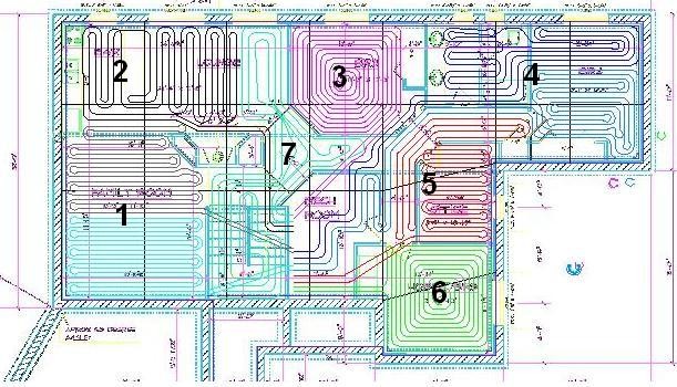

Here's an updated design. Still no heat gain/loss calculations, but I'm working on those and we'll make changes if we need to. So, they are all 300 ft coils give or take a few feet. 1/2" pex with oxygen barrier. We decided to go 6" o.c. under carpeted areas, 8" o.c. in exposed concrete areas. We have 7 zones.
Zone 1 has two circuits. Zone 2 has 1. Zone 3 has one. Zone 4 has 2. Zone 5 has 1. Zone 6 has 1. And Zone 7 has 1, though I need to redo that one so i route more to the mechanical room and less under the stairs. Any comments will be welcomed.
The black square grid is the planned control joints. When we actually lay the pipe down, any pipe running under a joint we'll off-set to the side, but those that cross perpendicular to the joints need to be sleeved, correct? How do you sleeve the pipes that go through control joints? What do you use for sleeves.
Also, anyone uses those twisting insulation clips? We'd like to use those then lay the reinforcement mesh on top of the pipe, but we're concerned if they can be ripped off by the concrete guys walking over them as they work on the pour.
Thanks for all the help!

14 Sep 2008 12:22 AM
Posted By Boontucky-girl on 08/25/2008 12:23 PM
You really need to hire someone to do the heat load calcs, and the radiant design. You can use a program, like I did, such as HVAC Calc, which only cost about $50 for a 2 month license. However, it only gives you the overall heat loss, not as detailed as an HVAC contractor can do. My HVAC contractor nephew ran me a heat load calc that gave me a room by room analysis. Very enlightening. One of the smallest rooms had the highest heat load because of house orientation and size of windows. The program he uses, WrightSoft, costs thousands of dollars -- not something I want to buy!
So, because of the cost of the tools to do the job right your best bet is to find someone to do the heat load calculation and radiant design for you. House construction, orientation, shading, window size, location (determines min and max temps and degree days), air changes per hour, etc., are all factors that enter into the calculation. You also have to determine water temps, velocities (faster moving water doesn't cool off as much but costs more to pump), and tube spacing on a room by room basis. These factors then help decide how many zones are practical (the fewer the better), what sort of mixing valves you need, how many thermostatically operated and manually operated control valves you need, what the supply temperature from the heater should be, what type of control panel you need, and on and on.
Who knows, you may need a mix of 3/8" and 1/2" tubing spaced at 8 or 9" in the center of the room and 4 or 5" at the outer walls, or hotter water at the outer walls and cooler at the interior, or something of the sort. And then there's the differences between carpet and ceramic and stained concrete and hardwood floor covering. I'm just trying to point out there are too many variables for a novice to know and understand.
But, I do give you credit for trying!!

the radiant design is complicated, sometimes iterant.  once the heat loads are calculated, the floor coverings specified,  the tube spacing and water temperature are juggled to provide heat output to the rooms to satisfy the loads. in many cases, especially in colder climates, there might be supplimental heat needed.
here is a slab RH design that I did a few years ago showing different tube spacings and floor coverings. Notice the manifold locations and balanced tube lengths.
Its painfull to see you flounder on this design as a DIY. I do this design work for a living and I would be glad to do this design for you. I have the heat load software and Autocad for the drawings. I would estimate that your design would take me just over a day. If you like, you can give me a call and we can talk about it. Check out my web site. I have lots of pictures installing RH slabs in my home.

You are probably over stressing. You can avoid disaster and get a decent system by doing this: stick to a 250 max loop length, do 6" o.c. under carpet, 12" o.c. elsewhere, and isolate all major rooms on their own loops as much as humanly possible.
That leaves you in a place where you have very good flexibility to do whatever you need to do in the future. Maybe you won't utterly minimize your electrical consumption to a 50 watt resolution, or your water temperature to 5 degrees, but you will keep yourself out of trouble and know that if radiant can do the job, you are in a place where it can be done. If you want to DIY design, accept that the results won't be "perfection", and shoot for "pretty good". It's probably not worth the time you're putting in for the benefit you're likely to get.
If you want to CYA, use a manifold that can take loop actuators if you want to be able to add zoning later, and leave a wiring conduit from the manifold to your future mechanical location. Or, arrange to pressurize the pipe without a manifold or any manifolds, and delay that decision until down the road when you can figure out what zoning you want.
