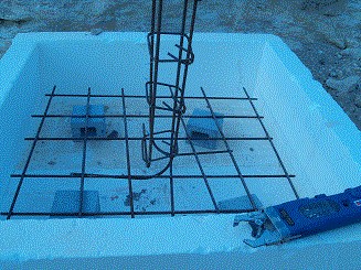

I have built a reinforced concrete post and beam home with surface bonded Geofoam panels as infill. It worked fine. 12 inch posts with 4 # 4s, 12X16 Beams 2-#6s and 2-#4s, Contained 6 foot by 6 foot footings. Three stories worked well. I poured the beams on top off placed Geofoam panels. I made the forms DIY out of 6 inch foam panels strapped with banding and backed with OSB witch was removed and used after setting. This is a picture of one of the insulated footings prior to pour.
I still have the plans and details.

The 4 by 16 by 1 foot panels were placed between the posts. the post was wraped with foam and everything was poured in place, posts and beams one floor at a time. the rebar work was was a lot more time intensive than originally thought.
No, I would not do it again. I have developed better methods that are easier, less time intensive, more thermally efficient and lower cost for materials to deliver a better porduct.
