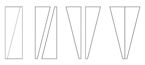

There is a way to use SIPs to build a segmented circular house and not have any waste but the width of the SIPs will dictate the length of your wall segments. One would cut the SIP diagonally in half, then connect the two pieces back to back with a spline. This would give you a triangular section of roof with an eave edge that is 8' wide by however long the panel was.

Here's a diagram. Would work for metal panels with a symetrical male/female lock like Structall's or PFF's. Won't work with a metal 'shiplap' male/female locking panel like Kingspan because when you flip the other half of the panel it reverses the lock and they won't mate.

Actually, you could still layout a roof with 'shiplap' locking metal panels, but you would have to cut up the panels in pairs and alternate the way you cut them, then swap out the halves so they will mate. Tricky.
