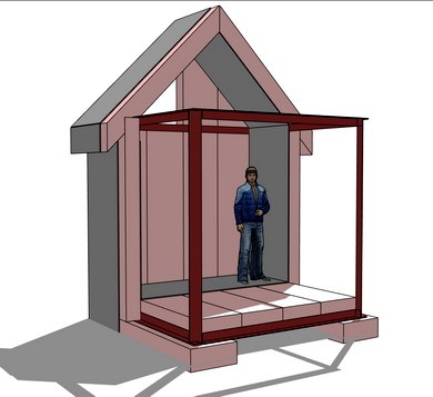

OK,OK, I confess, That EPS Foam with Concrete or MGO Skins are superior to OSB Skinned PU. Here is an example.
