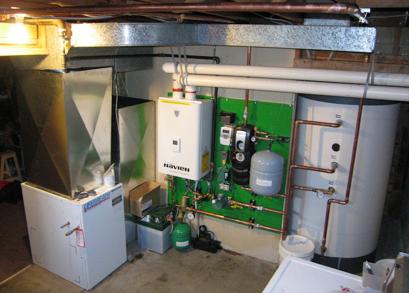

I was just pointing out the as-operated issues, since he seemed to be going for it over the other options discussed.  As a primary HW heater Naviens are pretty good (but the condensing Noritz models have tighter temperature controls and some other nice features.)   A buddy of mine uses a Navien as his solar backup using a circulation pump for maintaining the solar store. (This system was a space heating & hot water retrofit to an existing home in Utah, replacing a hot air furnace and gas-fired tank.)
In his case that choice had more to do with the fact that where it needed to be located the expense of stainless Z-vent for a standard-efficiency unit made the condensing Navien & PVC venting both cheaper and slightly more efficient:
http://lh4.ggpht.com/johnleeinslc/SNJhCkfHYsI/AAAAAAAADL0/E7DCGrqnRNs/s800/IMG_3643.jpg
(Note the length of the vent pipe!)
I didn't do the design and am not privy to all of the design constraints, but I suspect for slighly less money he might have gotten as-good or better efficiency for less money with a ~50KBTU condensing boiler, given the size of the solar store. In this mode the modulating & finer temperature control of the tankless on-demand is somewhat wasted (much as it is in my combi system, based on a Takagi on-demand heater.)
