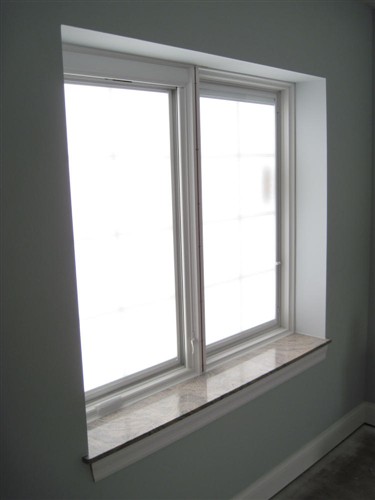

02 Dec 2011 06:27 PM
Posted By Lbear on 27 Nov 2011 03:58 PM
I still wish there was some sample pictures that can be shown on how the interior window is finished architecturally. How the window sill looks, do they drywall it or put a wood sill plate?
Here are a couple of pictures of the interior detail on two types of windows I incorporated in my ICF house.
First is a casement window, recessed with wrapped drywall and a granite sill.

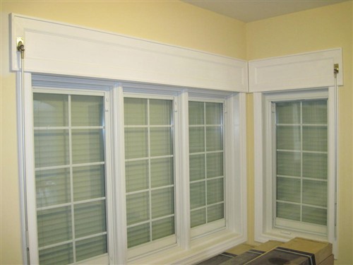

Second is a set of casements with rolling shutters.  The windows are recessed on both the interior and exterior.   The rolling shutters are stored within the ICF wall and accessible through the panels shown at the top of the windows.  Note that the shutters are controlled by cranks and are deployed (down) in this image.
When the rolliing shuttles are retracted (up) all the way, they are not visible on the exterior of the building.

Posted By Clark on 02 Dec 2011 06:27 PM

03 Dec 2011 10:07 AM
Posted By Lbear on 03 Dec 2011 03:45 AM
In regards to the shutters, how are they installed within the ICF wall? They would have to be installed on the OUTSIDE of the ICF wall in order to cover the exterior side of the window, correct? How then are they accessed from the INSIDE of the wall? I am confused.
Are the shutters mainly for privacy or do you live in a tornado or hurricane zone? Have you had any problems with them (binding, falling off tracks)?
That's the nice thing about the 12.5" thick ICF walls -- they are thick enough to contain the takeup box and mechanism of the rolling shutter, completely hiding the shutter from view until it is rolled down over the window.  Maybe these pictures will help explain how they were installed.
You have to plan for the installation of the rolling shutter when building the ICF forms.  The window bucks need to be high enough to accommodate the shutter takeup reel enclosure.  I opted for the interior crank to raise and lower the shutter.  A motorized shutter option is also available.
Here's an exterior view before the siding and trim were installed.  The aluminum shutter guides are embedded behind the exterior trim to make them unobtrusive.
This picture shows the finished exterior with the shutters part way down.
The rolling shutters provide complete control over the brutal sunlight entering the window later in the afternoon.   They also provide security, privacy, storm protection and reduced heat loss in the winter.  The windows stay cleaner, as well, during summer rains if the shutters are rolled down.  These shutters are well made and work reliably.  No regrets on incorporating them into the house design.
--Clark

With the design setup you have done, by placing the shutter assembly on the inside of the home, how much heat/cooling loss do you experience from that area? Being the shutter reel assembly occupies a space that would have been EPS & 6"+ of concrete. You can't really add cellulose up there, so it looks like a potential spot for a lot of energy loss.
What kind of ICF did you use? You mentioned that the walls are 12.5" thick. Are you including the thickness of the siding?
What shutter brand did you use?
ClarkUser is Offline
Posts:248
03 Dec 2011 08:00 PM
Posted By Lbear on 03 Dec 2011 04:49 PM
THANKS for all the info! With the design setup you have done, by placing the shutter assembly on the inside of the home, how much heat/cooling loss do you experience from that area? Being the shutter reel assembly occupies a space that would have been EPS & 6"+ of concrete. You can't really add cellulose up there, so it looks like a potential spot for a lot of energy loss. What kind of ICF did you use? You mentioned that the walls are 12.5" thick. Are you including the thickness of the siding? What shutter brand did you use?
I was able to insulate the area above the window where the rolling shutter reel is located.  The rolling shutter box was 7" deep, so I was able to put 2" of rigid foam behind the interior access trim panel.  Keep in mind that the energy loss through the triple glass windows is substantial compared to the ICF walls (R3 vs R22), so the R14 of rigid foam insulation over the roll shutter box represents only a small additional heat loss.  That heat loss is more than compensated for by the lower heat loss at night with the window glass shielded from the wind by the insulated roll shutter.  Heat gain from sun in the summer is almost completely stopped when the shutter is down.  There are perforations in the couplings between the individual slats which allow some light to enter the room if the shutters are not allowed to fully mate when the shutter is deployed.
I used TF System vertical ICF, but my approach to installing rolling shutters can be used with any ICF product provided the overall thickness of the wall, including the EPS is sufficient.  My ICF walls on the main floor are 10.5" thick (5.5" of concrete with 2.5" of EPS on each side).  I mistakenly said 12.5" thick earlier, but that was the thickness of the foundation walls, not the above grade walls.  Interior and exterior finishing is not included in this wall thickness dimension.  I covered the ICF with 1/2" gypsum board on the inside and Hardie board lap siding on the outside.
The brand of roll shutters I purchased was Rollac Rolling Shutters.  They are made of extruded aluminum with a foam insulation core.
