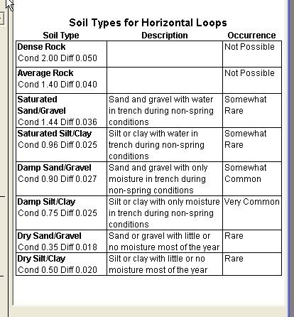

I have attached a table showing soil types.  Pick out the one that you think matches your soil and let us know.

Attachment: SoilTypes.jpg

Our contractor listed our soil type as "Damp Silt/Clay." Although there's nothing damp about the central Texas region right now, my husband mostly concurs about the silt, saying that it's more sandy than clay.
